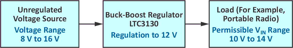

Figure 1 shows a system diagram of such an application. A portable radio device is supplied with voltage by a battery. The load can handle between 10 V and 14 V, but the voltage source has a possible output range of 8 V to 16 V. An interposed buck-boost regulator can thus convert the voltage to 12 V at the output. If the supply voltage is somewhat lower than 12 V, the converter works in boost mode, and if it is above 12 V, it works in buck mode.
A system in which the permissible voltage range of a load is narrower than the possible voltage range of the energy source.
Figure 1. A system in which the permissible voltage range of a load is narrower than the possible voltage range

A system such as the one shown in Figure 1 works well – however, improvements can be made. If the voltage source is at a voltage that can directly supply the load for most of the time, a buck-boost regulator can be used in PassThru mode. Here, the circuit designer defines an input voltage range within which the input voltage is passed directly to the output of the buck-boost regulator. The advantages of this are that there are no switching losses whatsoever and the circuit efficiency is very high. In addition, the circuit is operated with extremely low electromagnetic emissions because there is no pulsing of currents in this operating mode.

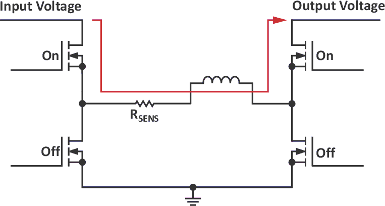

Figure 2 shows the power stage of a LT8210 buck-boost controller circuit with PassThru mode. In this mode, the two high-side switches of the H-bridge are permanently on and the two low-side switches are permanently off. Through this, depending on the currents and voltages, efficiencies of just below 100% are possible.
An LT8210 buck-boost regulator with PassThru mode for passing a voltage in standard operation.
Figure 2. An LT8210 buck-boost regulator with PassThru mode for passing a voltage

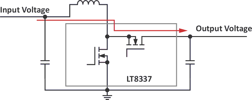

Besides a buck-boost solution (LT8210), boost regulators are also available with PassThru mode. The LT8337 Silent Switcher boost regulator from Analog Devices has an integrated PassThru mode. Figure 3 illustrates the concept behind the LT8337 boost converter. When PassThru mode is active, the high-side switch is permanently on and the low-side switch is permanently off.
An LT8337 boost regulator with Silent Switcher technology that also offers PassThru mode.
Figure 3. An LT8337 boost regulator with Silent Switcher technology that also offers PassThru mode.
In boost regulators, the high-side switch is usually executed with a flyback diode. Through this, an increased regulator supply voltage lying above the set output voltage is automatically passed through the inductor and the flyback diode. A dedicated PassThru mode, however, helps strongly reduce the voltage drop losses of the diode by actively switching on a high-side MOSFET. The PassThru mode also takes care of switching off all unnecessary functions of the LT8337. As a result, the IC itself can reach a current consumption of just 15 µA. This is very useful, especially for battery-operated applications.
