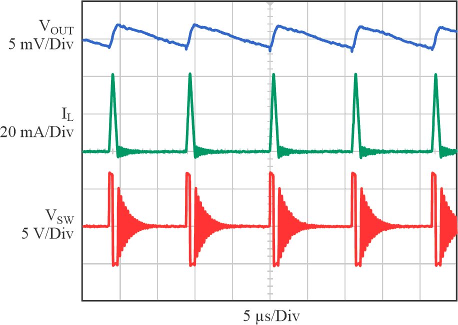

Many applications need very high conversion efficiencies, even with low output loads. If the required output power is just a few mW, the supply current for the switching regulator itself is weighted heavily out of proportion. This is especially true if the efficiency is expressed as a percentage. To increase the efficiency in these cases, the switching regulator IC is frequently equipped with a special burst mode. Figure 1 shows the voltage over time of a switching regulator in Burst Mode. The switching node switches once before changing over to a longer pause phase. During this pause phase, numerous functions of the switching regulator IC are put into a sleep mode in which only a very low amount of supply energy is needed. The switching node voltage, the inductor current, and the output voltage are shown in Figure 1.
The concept of Burst Mode in a switch-mode power supply.
Figure 1. The concept of Burst Mode in a switch-mode power supply.

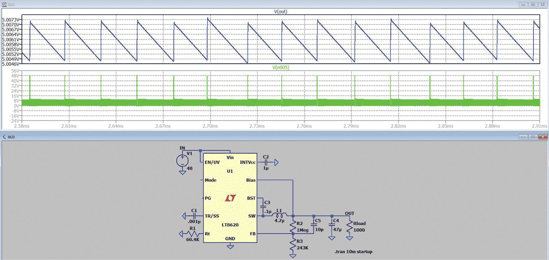

The voltage ripple of the output voltage is higher during operation in Burst Mode. It has a much lower frequency than the voltage ripple set in normal operation by the switching frequency. Depending on the voltage converter IC and the circuit conditions, operation during the burst phase is implemented with a very small number of pulses – for example, one pulse or with a large number of pulses (Figure 2). Usually, as many pulses as necessary are generated until the output voltage reaches a set upper threshold. This is followed by a pause that lasts until the output voltage falls below a minimum threshold. Here, switching still occurs with the selected switching frequency during the pulses, but the much lower frequency defined by the burst phases and the pause phases also appears in the spectrum.
Моделирование импульсного понижающего регулятора LT8620 в пакетном режиме с помощью LTspice.
Figure 2. Simulation of an LT8620 step-down switching regulator in Burst Mode with LTspice.

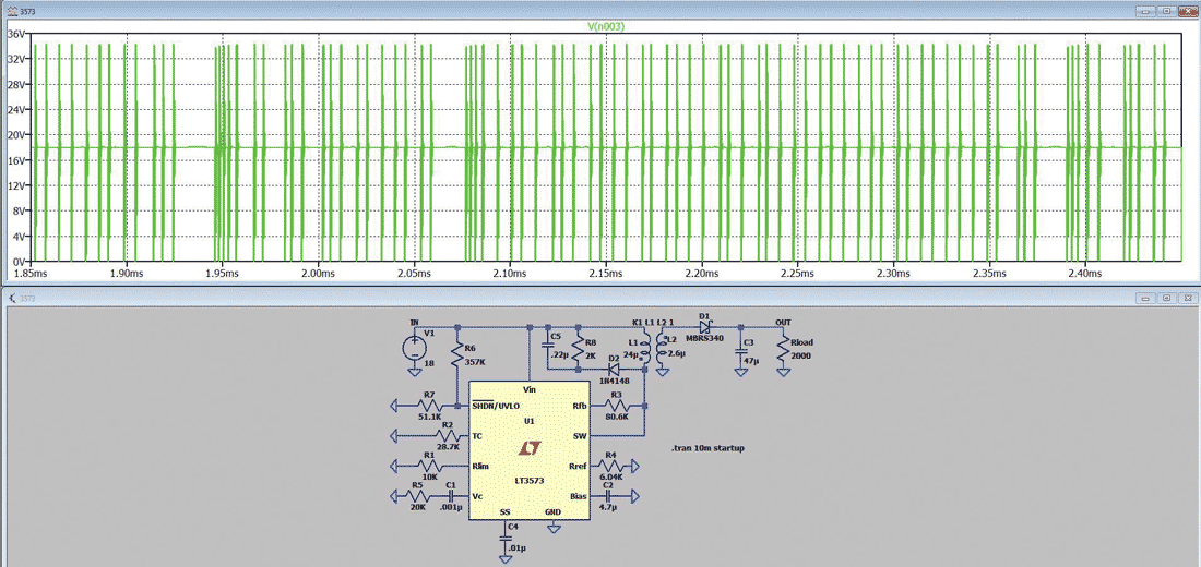

Another mode is the pulse skipping mode. It can be found in many different types of power converters. In many topology designs, each time there is a pulse at the switching node, a certain amount of energy based on a normal minimum on time is moved from the input side to the output side of the power converter. However, if at this time, no energy or just a small amount is required by the load, the output voltage rises. Some pulses are skipped to prevent the output voltage from rising too much (Figure 3). Here, too, the voltage ripple of the output voltage increases. The pulse skipping mode is usually activated through an overvoltage comparator at the feedback node. If, for example, every second pulse is left out, a switching frequency corresponding to half of the set switching frequency will be visible in the spectrum (FFT representation).
An LT3573 in pulse skipping mode with a low load.
Figure 3. An LT3573 in pulse skipping mode with a low load.
In contrast to Burst Mode, the pulse skipping mode only involves keeping the output voltage within a certain range and does not save any significant amount of energy. The conversion efficiency thus only improves slightly.
