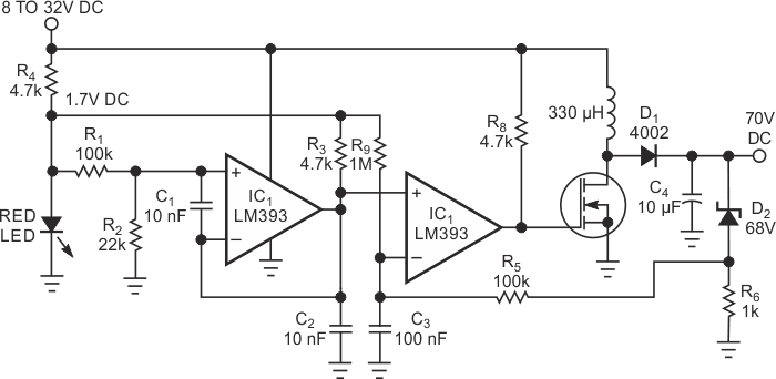

Figure 2, a 70 V-dc upconverter, employs the ramp generator. You can easily configure it at any output ranging from the highest input voltage to whatever the FET can handle. This example uses a 330-µH inductor, but you can easily change that value by choosing the appropriate PWM frequency.
| Figure 2. | A 70 V-dc upconverter employs the ramp generator. |
Note that the output FET does not turn on quickly, and it doesn’t need to, but it does turn off quickly. You can enhance the turn-off speed by adding a 2N4403 PNP transistor between the output of the comparator and the pullup resistor. Connect the base to the comparator, the emitter to the FET gate, and the collector to ground. Add a 100 Ω resistor from the base to the emitter.
The circuit has slow load-transient response, which you can adjust by altering the time constant that R5 and C3 form. Note that R9 and R5 form a voltage divider that ensures the lowest error voltage at the PWM comparator is above the ramp’s lowest point. The converter cannot operate without R9.
