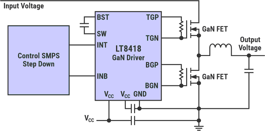

To effectively address the specific control requirements of GaN switches, specialized GaN driver ICs such as the LT8418 are recommended. Figure 2 shows an application of this driver in a downconverting switching regulator. The LT8418 GaN bridge driver offers a driver strength of up to 4 A for gate charging and up to 8 A for gate discharging during shutdown. By utilizing separate control lines for charging and discharging, different rise and fall times can be achieved, ensuring robust operation.
The LT8418, a 100 V half-bridge driver for GaN switches.
Figure 2. The LT8418, a 100 V half-bridge driver for GaN switches.
The circuit in Figure 2 achieves a conversion efficiency of approximately 97% at 48 V input voltage, 12 V output voltage, and 12 A load current. Notably, this high efficiency is attained at a 1 MHz switching frequency.
When building a power stage with GaN switches, careful attention must be given to optimizing the board layout. The fast switching edges, combined with parasitic inductances, can result in undesirable high electromagnetic radiation. To minimize these parasitic inductances, a compact design of the circuit is essential. This is why the LT8418 bridge driver is packaged in a compact wafer-level chip scale package (WLCSP) measuring only 1.7 mm by 1.7 mm.

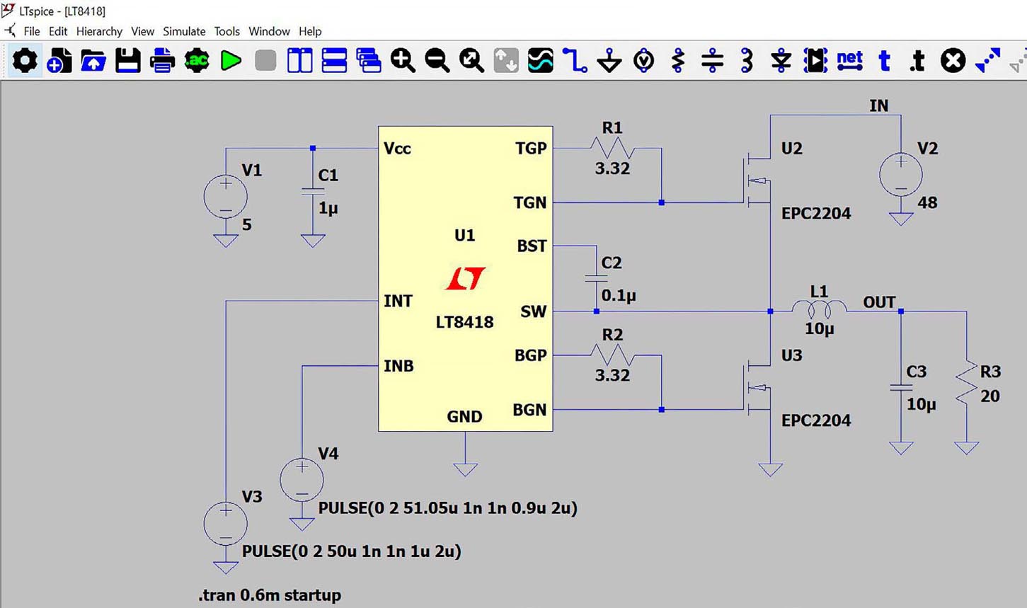

For quick and efficient experience with the control of GaN switches, the free simulation environment LTspice is highly recommended. LTspice includes a comprehensive simulation model of the LT8418 GaN driver, complete with external circuitry. Figure 3 shows a schematic of the LT8418 for evaluation within LTspice.
Evaluating an SMPS with GaN power switches within the LTspice simulation environment.
Figure 3. Evaluating an SMPS with GaN power switches within the LTspice simulation environment.
