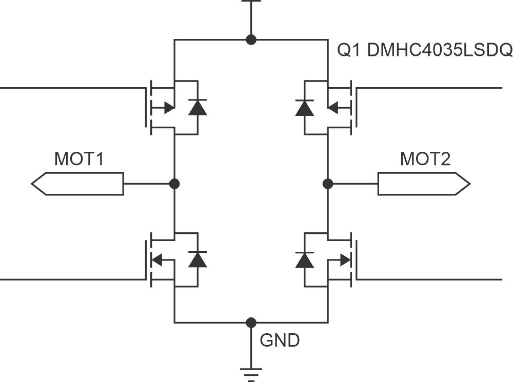

A brushed motor requires only a single transistor and a flyback diode to move in one direction and, as shown in Figure 2, it requires a circuit called an H-bridge if a change of direction is required. The flyback diodes in Figure 2 provide a safe route to ground for the back EMF that could otherwise cause damage. In contrast, a brushless motor requires a full H-bridge to move at all.
H-bridge gate arrangement.
Figure 2. H-bridge gate arrangement.
The H-bridge uses four transistors to control the current flow: Q1, Q2, Q3, and Q4. When Q1 and Q4 are on, current flows through the motor (labelled BDC) from left to right, causing it to rotate. Alternatively, if Q2 and Q3 are on, the current flows right to left, resulting in rotation in the opposite direction.

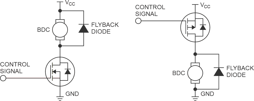

Firstly, for a simple single-direction application, such as a toy, the Diodes DMTH4008LFDFWQ is a MOSFET that provides the required switching to enable speed to be controlled (Figure 3). The device is rugged, operating at up to 175 °C; provides high power density, up to 40 V and 11.6 A; and in a compact 2 mm × 2 mm package.
Single direction brushed DC motor control.
Figure 3. Single direction brushed DC motor control.
For a bidirectional brushed motor to, for example, move a car’s door mirror, an H-bridge is required (Figure 4). This example uses the Diodes DMHC4035LSDQ, which provides an H-bridge that can switch up to 3 A, in a simple, single package. This part can also be used to control a single-phase brushless motor.
Bidirectional brushed motor control.
Figure 4. Bidirectional brushed motor control.
