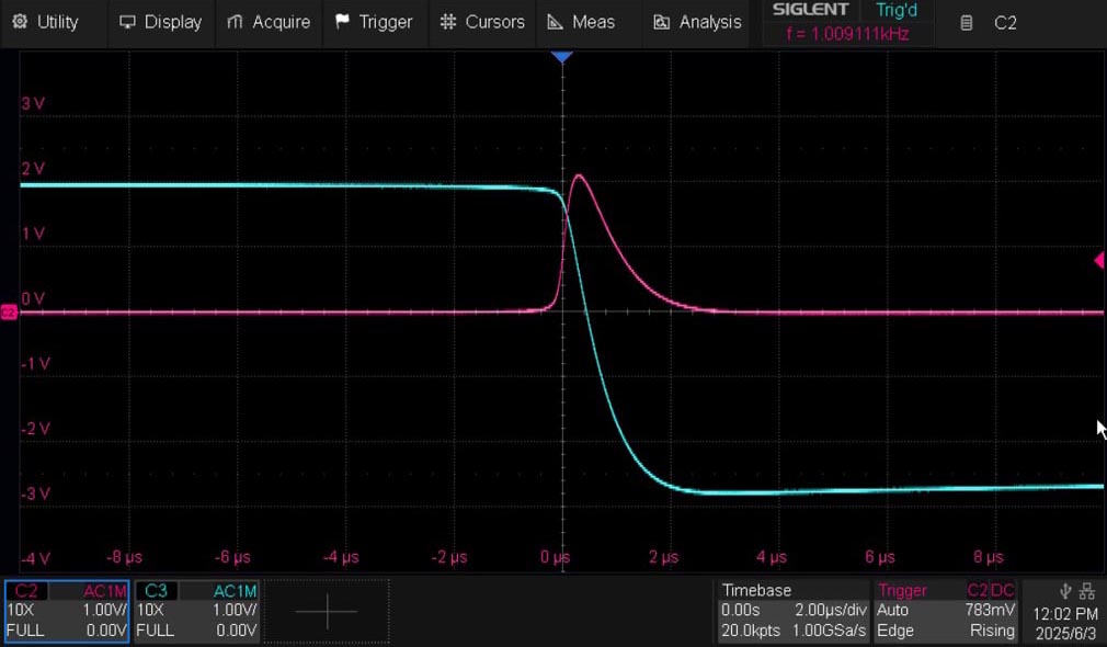

A simple circuit was created with the 2N3904 emitter connected by a 100-kΩ resistor to a variable supply set to ~14 VDC. A shunt capacitance of 10 nF from the emitter to ground and a 50-Ω resistor from the collector to ground. Just two resistors, a capacitor, and the 2N3904 are all that’s required to create a simple relaxation oscillator (actually, the 50-Ω resistor isn’t required).
Figure 2 shows the result with the DSO AC-coupled blue trace, the relaxation voltage at the transistor emitter, and the DC-coupled magenta trace, the voltage across the 50-Ω resistor from the collector to ground (remember the NPN is upside down or inverted!).

The pulse across the 50-Ω resistor in Figure 3 shows the avalanche current in more detail, where this current is ~ 2 V peak across the 50-Ω resistor, or ~40 mA peak. This isn’t fast, however, the 2N3904 is a general-purpose (GP) transistor that is not intended for speed.
Avalanche current shown in more detail on the DSO, showing a ~40 mA peak.
Figure 3. Avalanche current shown in more detail on the DSO, showing a ~40 mA peak.
