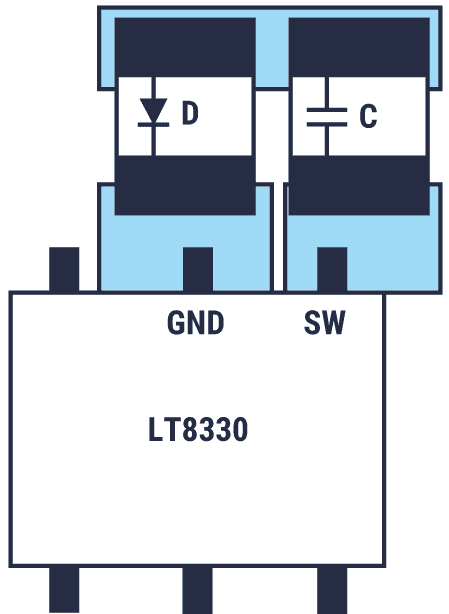

Above all, the two required inductors represent a cost and space factor. However, these two components also lead to an inductance in the power path on both the input side and the output side. This prevents rapidly switching currents at the input and also at the output. As a result, the Ćuk topology is generally considered to be a particularly low noise topology. Of course, just like every other switching regulator, a Ćuk topology has switched currents. They are shown in Figure 1 as the hot loop in blue. By the term hot loop, we mean the group of traces with fast di/dt transitions. In order to minimize the interference generated by the switched currents, the parasitic inductance and, with it, the spatial expansiveness of this loop must be designed to be as small as possible.
Therefore, in an optimal board layout for a Ćuk converter, the freewheeling diode D, the coupling capacitor C, and the switch S1 must be brought very close together. With the corresponding pinout of an IC such as the LT8330, compact arrangement of these lines is no problem. Figure 2 shows the region of the power paths of the switched currents (hot loop) in a concrete board layout.
Board layout optimized for the Ćuk topology.
Figure 2. Board layout optimized for the Ćuk topology.
The critical loop is made up of the external diode D, the coupling capacitor C, and an internal connection between GND and the SW pin within the LT8330 switching regulator IC. The hot loop is designed to be as small and compact as possible.
