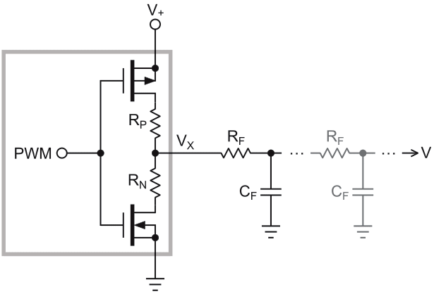

Simplicity and low cost sustain the popularity of passive PWM DAC ripple filters despite their limitations. One of these limitations is a high output impedance caused by the series sum of filter resistance(s) (RF in Figure 1, one resistor for each cascaded filter RC stage), making overall DAC accuracy very sensitive to output loading. The designers’ recourse, unless they want to resort to active output buffering and thus lose some of that wonderful PWM simplicity and cheapness, is to make RF as low as practical.
A generic passive PWM filter topology with one resistor (RF) for each cascaded filter RC stage.
Figure 1. A generic passive PWM filter topology with one resistor (RF) for each
So, how low is practical and what factors set the limit?
Although a ripple filter may comprise multiple stages, the first stage will generally take center stage in the “how low to go” decision, for these reasons:
In virtually all (even in multi-stage) ripple filter designs, RF of later stages (if any) are proportional to the first stage’s RF. So, when it’s known, they, and therefore the final DAC output impedance, are also known.
To a good approximation, the full peak-to-peak V+ PWM waveform amplitude usually appears across the first stage RF, so that practicality-limiting factors like power and current draw are almost entirely determined by its resistance. Worst case average power and current draw typically occur at or near 50% PWM duty cycle and are given by:
where RN is the N-channel switch’s on-resistance and RP is the P-channel switch’s on-resistance.

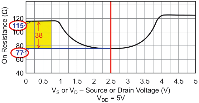

When Z = 156 Ω, the ripple filter is almost as good as a buffered output in some circuit states. This is surprising performance for a simple and cheap passive filter. But is it ultimately practical? The arithmetic above implicitly assumes RN = RP. What happens if they’re not, as shown in Figure 2’s on resistance (RON) versus source or drain voltage (V) graph for the sort of switch (TMUX4053) that might be used to generate a precision 2.5 V PWM waveshape?
On-resistance versus source or drain voltage for the TMUX4053 with an unequal at
Figure 2. On-resistance versus source or drain voltage for the TMUX4053
with an unequal at
At 25 °C RP is 77 Ω and RN is 115 Ω. If we make:

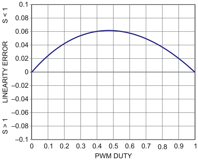

Unfortunately, while okay for minimizing output impedance, this much up/down resistance asymmetry is a bad thing for DAC integral linearity. Figure 3 shows the effect of S = 0.78 on linearity: A deal-breaking >6% of full-scale deviation from accurate linearity.
In fact, this is a general result. For any given S, integral nonlinearity of approximately:
can be expected, with deviation from linear going positive for S < 1 and negative for S > 1.
Linearity error versus PWM duty where S = 0.78 creates ~6% of integral nonlinearity.
Figure 3. Linearity error versus PWM duty where S = 0.78 creates ~6% of integral
nonlinearity.
