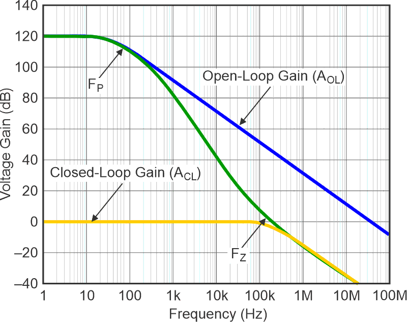

The op amp drives a 10-μF capacitor, C4, and the ADC’s voltage-reference input pin. The charge residing on C4 provides the needed charge during the ADC’s conversion. During the ADC’s acquisition and conversion, the size of C4 provides a stiff voltage reference for the ADC’s reference pin, which usually has an input capacitance of approximately 2 to 50 pF.
A circuit with good stability is one in which the modified op amp's open-loop-gain curve and the closed-loop voltage-gain curve's rate of closure is 20 dB.
Figure 2. A circuit with good stability is one in which the modified op amp's

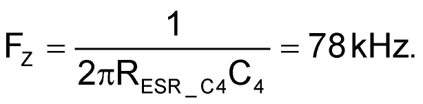

You can compromise the amplifier’s stability because C4 and the op amp’s open-loop output resistance, RO, modify the amplifier’s open-loop-gain curve. Basically, a circuit with good stability is one in which the modified op amp’s open-loop-gain curve and the closed loop voltage-gain curve’s rate of closure is 20 dB (Figure 2). In this stable circuit, the following equations calculate the frequency locations of the pole and zero:
The open-loop output resistance of the OPA350 is 50 Ω, and the ESR (equivalent series resistance) of C4 is 2 mΩ.
