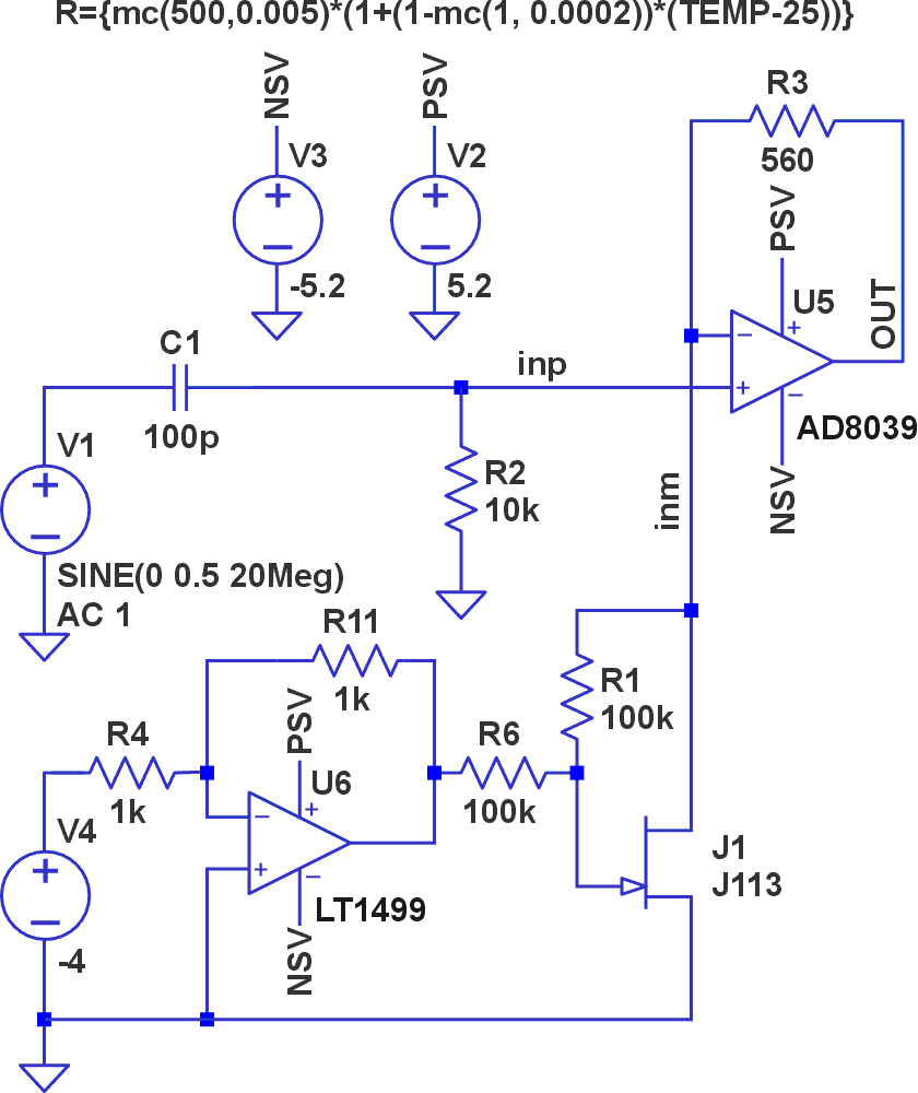

The circuit shown in Figure 1 is a wideband gain amplifier stage built around a JFET transistor. This type of circuit is commonly used to convert a photodiode current into a voltage signal. This configuration enables a linear gain control over a range spanning up to three decades, thanks to the JFET placed in the feedback path of a non-inverting amplifier. onsemi describes this circuit in detail in application note for AN-6603 power MOSFET (Ref. 1).
The examined circuit (used commonly, for example, to convert a photodiode current into voltage) is a large band gain amplifier stage based on a JFET transistor (J113). This linear control function is achieved with this JFET in the feedback path of a non-inverting amplifier.
Figure 1. The examined circuit (used commonly, for example, to convert a photodiode current into voltage)

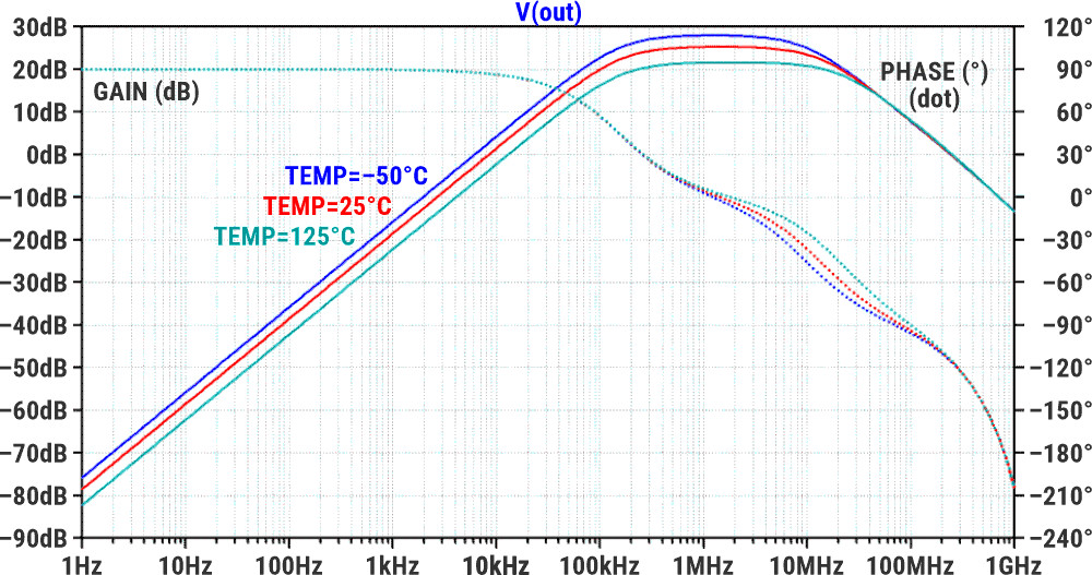

But what about temperature fluctuations? Thanks to the very powerful SPICE simulator LTspice from Analog Devices (Ref. 2), the AC small signal gain frequency (1 Hz up to 1 GHz) analysis of the circuit of Figure 1 is straightforward, and the parasitic temperature effect (from –50 °C up to 125 °C) can be directly represented in Figure 2.
The cause of gain variation in temperature shown here can be attributed to the BETATCE transconductance temperature coefficients (in %/°C) of the J113 JFET.
Figure 2. The cause of gain variation in temperature shown here can be attributed to the BETATCE
onsemi’s application note acknowledges that the gain of this circuit is temperature-dependent, a result of the JFET’s inherent sensitivity to temperature. The note also briefly mentions that this effect may be mitigated by using a silicon resistor for the feedback resistor R3 – but offers no further guidance. This lack of detail left the author looking for a clearer solution.

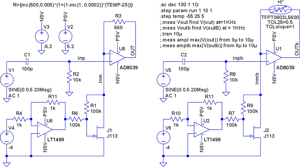

Both versions of the circuit – the original and the one modified with the TFPT – are shown in Figure 3. For simulation accuracy, all relevant tolerances are included: those on the ambient resistance values, on the temperature coefficient of the fixed resistor, and on the TFPT itself. The simulations randomly vary these parameters. To ensure a fair comparison, the ambient resistance tolerance for both the fixed resistor and the TFPT is set to ± 0.5%.
The diagram shows the original (left) and modified (right) versions of the large band gain amplifier stage circuit.
Figure 3. The diagram shows the original (left) and modified (right) versions of the large band gain amplifier stage circuit.
The Figure 4 demonstrates a substantial improvement in temperature stability with the compensated TFPT0603 version.
