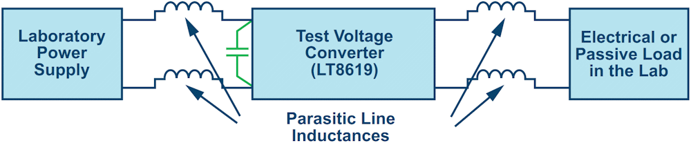

When connecting the test circuit, a few points should be considered. Figure 1 shows a schematic of the test setup. The design under test must be connected to a power supply on the input side and a load on the output side. This sounds trivial, but there are some important details that must be heeded.
Minimization of line inductances
Connections for operation of a power supply.
Figure 1. Connections for operation of a power supply.

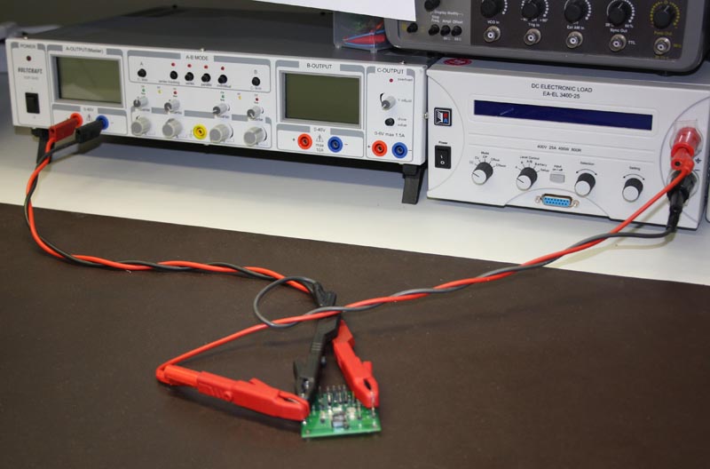

Figure 1 shows a schematic of the setup for evaluation of a power converter. We want to test the behavior of the power circuit and not the effect of the connection lines between the test board and the lab power supply or the load at the output. Two important measures should be taken to reduce the effects of these connection lines. For one, the connection lines should be kept as short as possible. Short lines have lower line inductance values than long lines do. Second, minimization of the current path area further reduces the parasitic inductance. An obvious way to accomplish this is to twist the lines. This results in the current path area only being dependent on the line length and the thickness of the stranded wire sheath. Figure 2 shows the connection of a test voltage converter with twisted connection lines for reduced parasitic line inductances.
Practical operational setup with short twisted cables.
Figure 2. Practical operational setup with short twisted cables.

Addition of a local energy storage device on the input
If a power supply is tested with respect to how quickly it can respond to load transients, sufficient energy must be available at the design under test. The energy source on the input side of the design under test should not be the limiting factor. To ensure that this is not the case, placement of a larger bulk capacitor at the voltage supply input is recommended. This is shown in green in Figure 1. It ensures that load transient tests can be performed properly.
However, it must be ensured that the later use of the power supply is subject to very specific conditions. The effect of the energy storage device at the input must be well understood so that the input capacitor for the power supply can be dimensioned correctly.
Another aspect of the bulk capacitor in Figure 1 must also be considered. If voltage transients need to be applied at the input of the power supply to test the resulting behavior, the bulk capacitor would considerably slow down the voltage transients seen by the circuit under test. Thus, for these tests, the capacitor should be removed.
