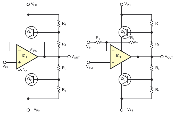

These simple circuits present the general methods of connecting the amplifier as an inverter or a follower to effect increased output voltage

Figure 1. These simple circuits present the general methods of connecting the amplifier as an inverter or a follower to effect increased output voltage
