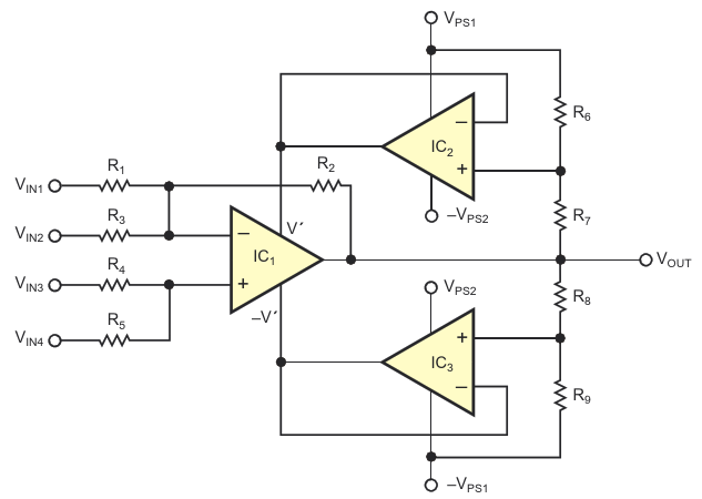

Replacing the transistors with op amps reduces losses and increases the quality of the output voltage of the primary amplifier
Yakov Velikson
Controlled power supply increases op amps' output-voltage range
Figure 2
23 Kb
Figure 1. These simple circuits present the general methods of connecting the amplifier as an inverter or a follower to effect increased output voltage
Figure 2. Replacing the transistors with op amps reduces losses and increases the quality of the output voltage of the primary amplifier
