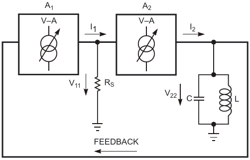

LC Oscillator has Stable Amplitude
Figure 2
16 Kb
Figure 1. A parallel LC circuit and an amplifying voltage-to-current converter form a basic oscillator
Figure 2. Adding a second voltage-to-current converter isolates the tuned circuit
