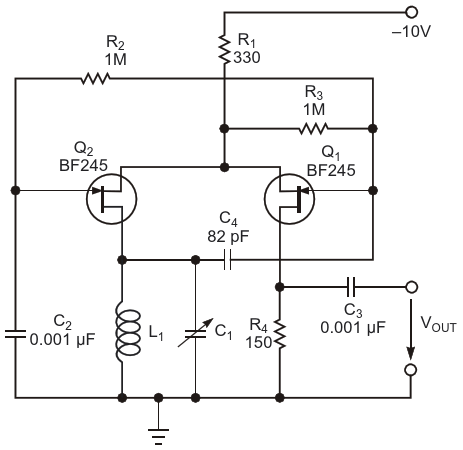

The completed oscillator circuit …
The completed oscillator circuit features a minimal component count

Figure 1. A parallel LC circuit and an amplifying voltage-to-current converter form a basic oscillator
Figure 2. Adding a second voltage-to-current converter isolates the tuned circuit
Figure 3. Rectifying a portion of the signal provides a gain-control voltage for the amplifiers
Figure 4. Control characteristics of an idealized JFET exhibit linear variation of forward transconductance versus gate-to-source voltage
Figure 5. The completed oscillator circuit features a minimal component count
