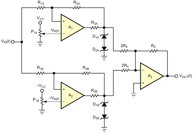

One straightforward way of obtaining a double-hysteresis-transfer characteristic uses three op amps with voltage references and zener diodes

Figure 1. One straightforward way of obtaining a double-hysteresis-transfer characteristic uses three op amps with voltage references and zener diodes
