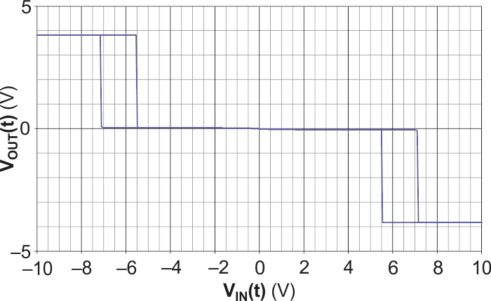

The I/O-transfer characteristic of the circuit in Figure1 exhibits two hysteresis bands.

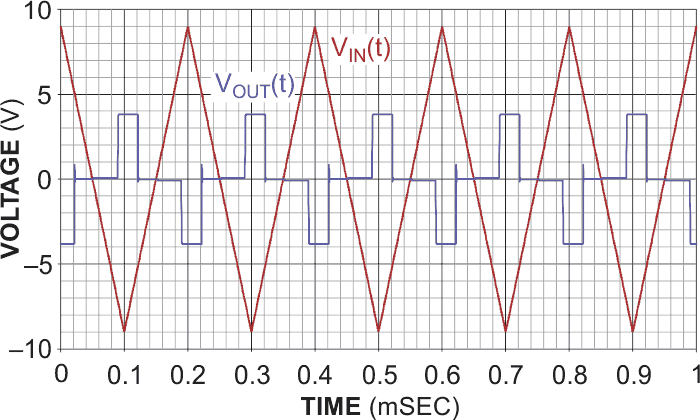

Figure 4 shows the I/O-transfer characteristic of the circuit with the values in Figure 3, where D1A and D1B are 6.8 V 1N4099 zener diodes and D2A and D2B are 3 V 1N5225 zener diodes. Figure 5 shows the output voltage when you apply a triangular waveform at the circuit’s input.
This oscilloscope trace shows the response of the circuit in Figure 3 to a triangular input waveform.
