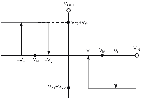

Single Op Amp Achieves Double-Hysteresis-Transfer Characteristic

Figure 2. The I/O-transfer characteristic of the circuit in Figure1 exhibits two hysteresis bands
