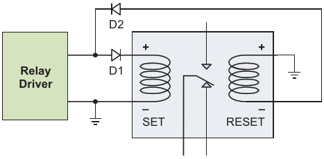

Diodes convert a single-coil relay driver to dual-coil use

Adapt single-coil relay driver to dual-coil use
Figure 1. Diodes convert a single-coil relay driver to dual-coil use
Figure 2. Four diodes are needed to convert the single-coil signal for dual coil use when the coils share a common connection
