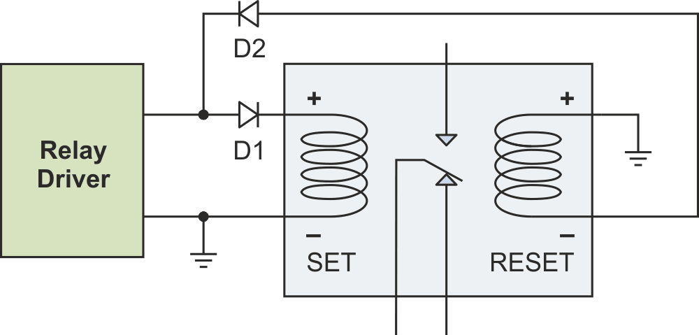

If you wish to use a dual-coil relay, but the only driver you have available is for a single-coil relay, there is an easy way to convert that single-coil driver handle the two-coil relay, shown in Figure 1. This conversion to positive-only drive is particularly useful for relay testing, because you need only one voltage polarity instead of two. This reduction can significantly simplify the relay testing setup.
| Figure 1. | Diodes convert a single-coil relay driver to dual-coil use. |
The operation is simple. When the coil driver output voltage is positive, current flow through diode D1 to energize the set-coil, while the reset-coil is unpowered because D2 blocks the current. The relay enters the set-state. When the voltage is negative, diode D1 blocks the current flow through the set-coil and diode D2 energizes the reset-coil.

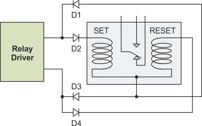

The latched relay in Figure 1 has two independent coil connections using 4 pins. Some dual-coil relays, however, use only three pins with a common coil connection as shown in Figure 2. This configuration needs a slightly more complicated configuration, involving four diodes.
| Figure 2. | Four diodes are needed to convert the single-coil signal for dual coil use when the coils share a common connection. |
As before, when the driver voltage is positive, current is flowing through diode D2, the set-coil, and D3. Diodes D1 and D4 are reverse biased, blocking the current to the reset-coil. Similarly, when the voltage is negative current flows through the diode D4, the reset-coil, and D1, while the set-coil is de-energized. Again only one coil is on at a time.

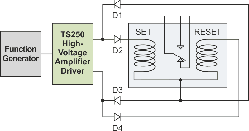

The conversion circuit has the additional benefit that it makes things easier when testing dual-coil relays for their AC performance characteristics, such as operate-time (turn-on time), bounce-time, break-time, and maximum frequency. Just replace the relay driver with a square-wave voltage signal generator. Because many relay coils require high voltage, up to 48 V, and high current anywhere from 20 mA to over 1000 mA in some cases, a signal generator alone may not be enough. In such cases a high-voltage function generator amplifier, such as the TS250 from Accel Instruments, is needed to boost the voltage and current (Figure 3).
| Figure 3. | Testing the dual-coil relay using only one function generator and a high- voltage driver. |
