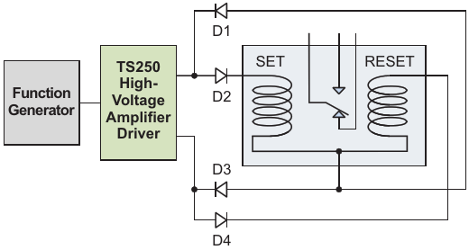

Testing the dual-coil relay using only one function generator and a high-voltage driver

Figure 3. Testing the dual-coil relay using only one function generator and a high-voltage driver
