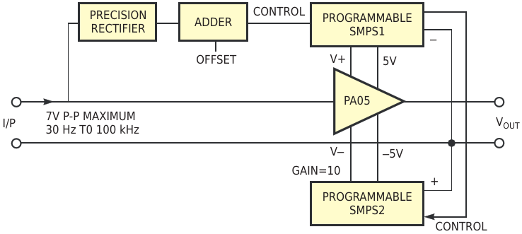

Power supplies track the input signal in bootstrap fashion, thus reducing power dissipation

Keep the heat down in power op amps
Figure 1. Power supplies track the input signal in bootstrap fashion, thus reducing power dissipation
Figure 2. The switch-mode power supplies track each other with opposite-polarity outputs
