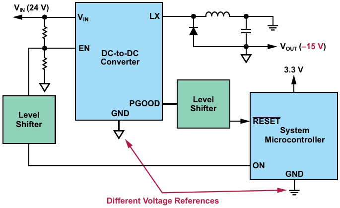

Figure 1. Example of a simplified schematic of a system using solely positive voltage rails
Figure 2. Example of a simplified schematic of a system using negative voltage rails
Figure 3. The typical level shifter circuit translates the ON command from the system controller
Figure 4. A level shifter translates the PGOOD signal from the DC/DC converter
Figure 5. A simplified schematic of a nonsynchronous, dual-inductor inverting output DC/DC converter
