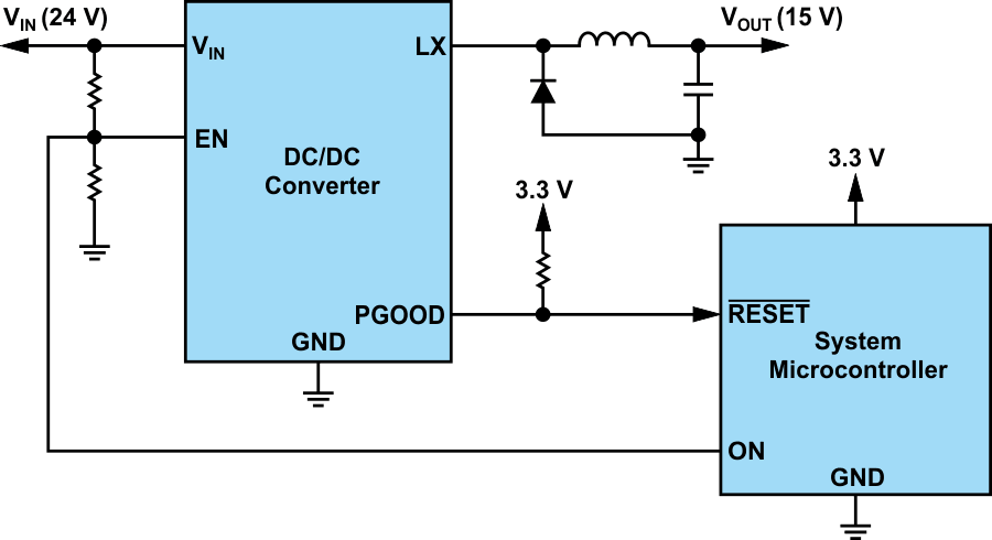

A typical power system has its lowest voltage potential as ground reference, or GND. For a positive output DC/DC output converter, the ground reference is simply the GND (0 V potential). Its input/output signals are naturally referenced to this ground. The system controller communicates with the DC/DC converter simply and directly to those I/O pins. Figure 1 illustrates such a system where the system microcontroller drives the EN (enable) pin of the converter to turn it on and off. The controller also reads the status of the converter through its PGOOD (that is, RESET) pin to know whether the converter power output is within its regulation and is ready for powering up the whole system. For simplicity, only one DC/DC converter is shown here, but the principle also applies to systems with multiple positive voltage rails.
Example of a simplified schematic of a system using solely positive voltage rails.
Figure 1. Example of a simplified schematic of a system using solely positive voltage rails.

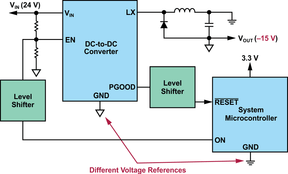

When a negative DC/DC converter is used, communication to the system controller is not trivial. The converter has its I/O pin referenced to its lowest voltage potential, which in this case is the negative output voltage, not the system GND. When using negative voltage rails, designers need to implement level shifter circuits for the system microcontroller to communicate with the DC/DC converter. Figure 2 illustrates a simplified schematic of a system with two level shifters.
Example of a simplified schematic of a system using negative voltage rails.
Figure 2. Example of a simplified schematic of a system using negative voltage rails.
Again, for simplicity, only one negative output DC/DC converter is shown here. But the principle applies to system with multiple negative voltage rails or with a mix of both positive and negative voltage rails. One level shifter is needed per each I/O pin of each negative output DC/DC converter.

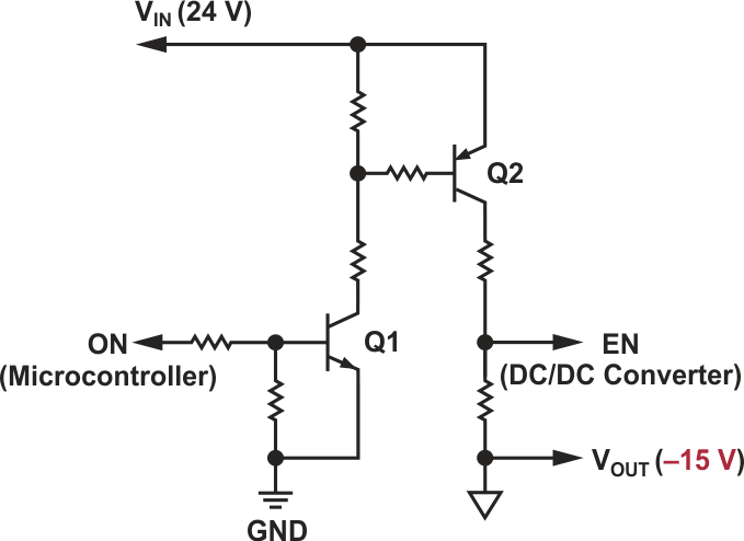

Figure 3 illustrates a typical level shifter circuit. Its purpose is to shift the ground reference of a signal to match that of the system microcontroller. It is used here to translate the ON command from the system microcontroller to turn on/off the DC/DC converter. This level shifter consists of nine components. Its operation is straightforward: when ON is driven high by the system controller, Q1 turns on, which in turn biases Q2 on and drives EN high to enable the DC/DC converter. When ON is driven low, both Q1 and Q2 are off and EN is driven low to disable the converter.
The typical level shifter circuit translates the ON command from the system controller.
Figure 3. The typical level shifter circuit translates the ON command from

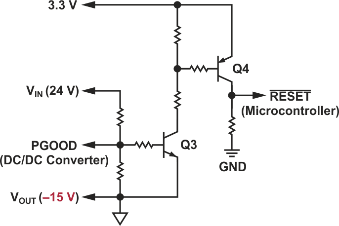

Figure 4 describes a common level-shifter circuit variation. It is used here to translate the PGOOD signal from the DC/DC converter so that the system microcontroller can read. When PGOOD is driven high (open drained) by the DC/DC converter, Q3 turns on, which in turn biases on Q4 and drives RESET high, taking the system microcontroller out of reset.
A level shifter translates the PGOOD signal from the DC/DC converter.
Figure 4. A level shifter translates the PGOOD signal from the DC/DC converter.
These 2 level shifters require 18 external components, imposing a challenge to the designers trying to fit the solution to the ever-shrinking equipment and board space.

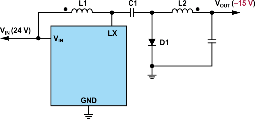

The legacy negative output DC/DC solution is inefficient. The extra heat generated due to inefficiency creates another challenge for designers, who now have the extra burden of removing that heat from the system. Figure 5 shows a simplified circuit schematic of such a system.
A simplified schematic of a nonsynchronous, dual-inductor inverting output DC/DC converter.
Figure 5. A simplified schematic of a nonsynchronous, dual-inductor inverting output
DC/DC converter.

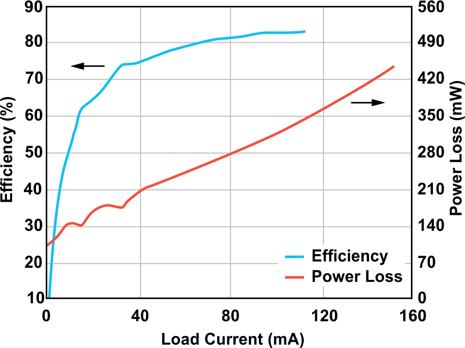

This topology faces two inefficiency issues. First, it employs nonsynchronous switching where the output rectifying diode, D1, dissipates more power compared to a synchronous solution. Second, it has an extra power inductor, L1, and an extra capacitor, C1, which also dissipate more power. Figure 6 shows the efficiency curve for this converter, measured at +12 V input and –15 V output. Its peak efficiency is only 83% while dissipating approximately 460 mW at 150 mA output current.
The power loss curve shows the efficiency of a nonsynchronous, dual-inductor inverting output DC/DC converter.
Figure 6. The power loss curve shows the efficiency of a nonsynchronous,

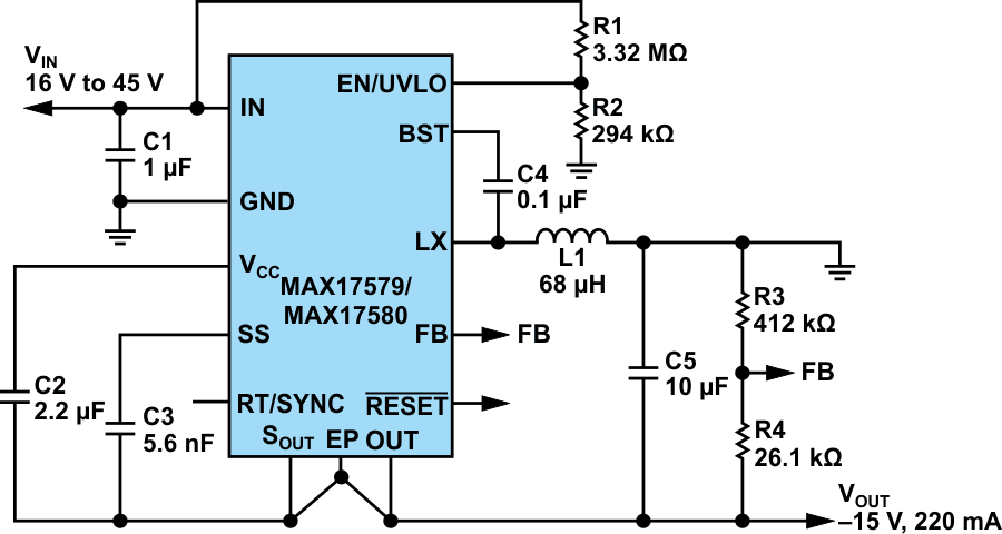

The MAX17577 and MAX17578 were developed to meet the growing requirements for smaller solution size and lower heat generating devices in factory automation, building automation, and communications systems. The devices integrate level shifting circuitry to reduce component cost and count, and they employ synchronous rectification for the best efficiency. These are the industry’s smallest and highest efficiency synchronous inverting DC/DC step-down converters. Figure 7 shows their typical application circuit.
Highly integrated, most efficient negative output DC/DC converter.
Figure 7. Highly integrated, most efficient negative output DC/DC converter.
The MAX17577 and MAX17580 have a wide input voltage range. The devices operate from 4.5 V to 60 V input and can deliver up to 300 mA output current. With integrated level shifters, these devices conserve up to 72% of board space by reducing component count by half while using 35% less energy than the closest legacy solution. Figure 8 shows MAX17577’s peak efficiency at 88.5%, measured at 16 V input and –15 V/150 mA output. This is 5.5% points of higher efficiency comparing to the legacy solution shown in Figure 6. Why is efficiency important? At 88.5% efficiency, the device dissipates only 292 mW while delivering 2.25 W power to the load. 292 mW means 37% less heat for the system to cool compared to the 460 mW amount of the legacy solution shown earlier.

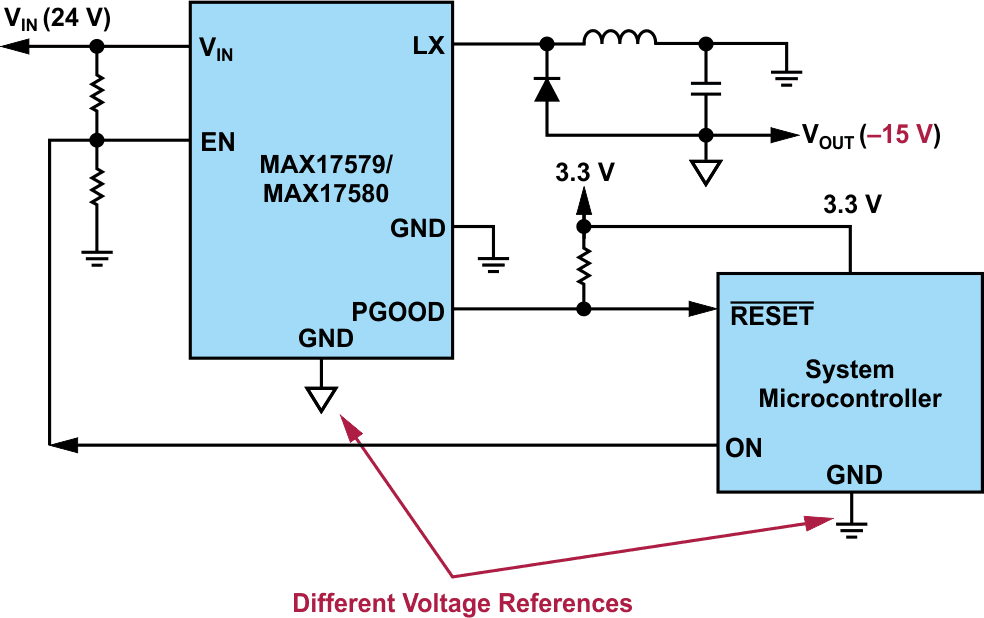

Figure 9 shows an improved version of Figure 2, eliminating the level shifters. The system microcontroller can communicate directly with MAX17579/MAX17580 even though they have different grounding references.
The MAX17579/MAX17580 in a system using negative voltage rails.
Figure 9. The MAX17579/MAX17580 in a system using negative voltage rails.
