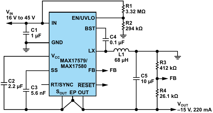

Figure 7. Highly integrated, most efficient negative output DC/DC converter
Figure 8. MAX17579's efficiency at -15 V output
