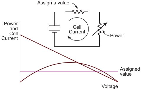

Figure 1. The load voltage versus cell and load current for a circuit where the voltage source is in series with some source resistance feeding power to a variable load
Figure 2. Power to the load (load voltage × load current) versus cell and load current
Figure 3. Adding a specific numerical value for the source resistance
Figure 4. Discovery of the peak power point by finding the equality between the load resistance to the source resistance
