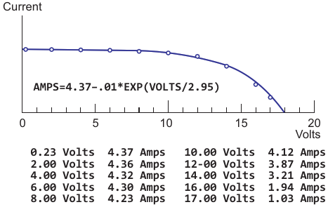

A numerical representation of the PV device shown in Figure 5

Figure 6. A numerical representation of the PV device shown in Figure 5
