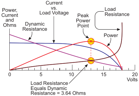

Figure 7. Current, power and dynamic resistance curves for the Solec S-70C PV device. The dynamic resistance of the PV here is no longer the static horizontal line we saw in Figure 3
Figure 8. Discovery of the peak power point for the Solec S-70C PV device
