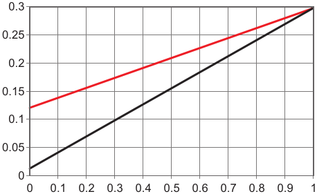

error plots where …
V
OUT
error plots where the x-axis is D and y-axis is V
OUT
error. Black line is V
OUT
= V
S
at D = 0 and red line is V
OUT
= 0 at D = 0

Figure 3. V
OUT
OUT
OUT
= V
S
OUT
= 0 at D = 0
