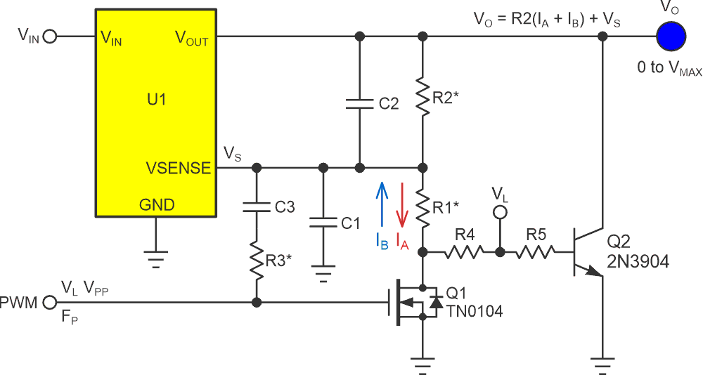

Figure 1 shows a basic topology for sub-VS regulator programming with current expressions as follows:
Basic PWM regulator programming topology.
Figure 1. Basic PWM regulator programming topology.

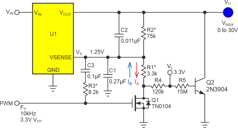

The simplest way to address this crucial question is to evaluate it as a plausible example of Figure 1’s general topology. Figure 2 provides some concrete groundwork for that by adding some example values.
Putting some meat on Figure 1's bare bones, adding example values to work with.
Figure 2. Putting some meat on Figure 1’s bare bones, adding example values to work with.
