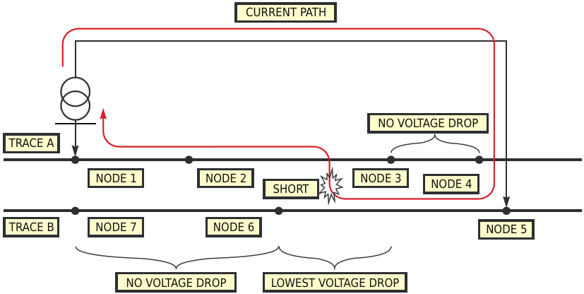

By applying a fixed current to various nodes and looking at the resultant voltage drops, you can home in on the likely location of a pc-board short circuit
AuthorsTeno P. Cipri
Main DocumentArticle «Quickly find pc-board shorts with low-cost tracer technique»
DescriptionFigure 1
File Format / SizePDF / 10 Kb
