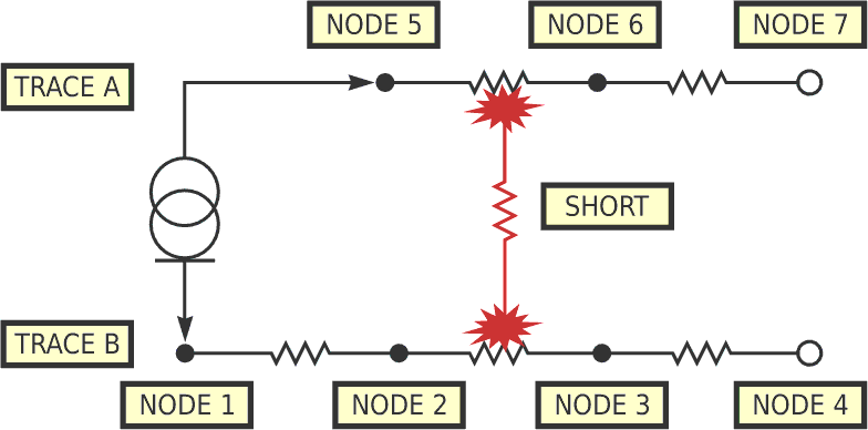

A node can be any accessible part of the circuit path under test, such as a via, a pad, or a test point (Figure 1). Note the current path: When current is flowing between two nodes, a minute voltage drop occurs across the two nodes. When the current doesn't flow between two nodes, there is no voltage drop across those nodes.
By applying a fixed current to various nodes and looking at the resultant voltage drops, you can home in on the likely location of a pc-board short circuit.
Figure 1. By applying a fixed current to various nodes and looking at the resultant voltage drops, you can home in on the likely
To find the short in this example, put one DMM probe on any node on Trace A and the other on any node on Trace B, and note the voltage drop. In this example, if you had started with the positive probe on Node 1 and the negative probe on Node 5 and moved the negative probe to Node 6, you would note a slight voltage drop. Next, you move the probe to Node 7 and note that the voltage drop is equivalent to the voltage drop at Node 6. From this test, you can deduce that the short must exist between nodes 5 and 6 because no current flows from Node 6 to Node 7. Then, move the positive probe to Node 2 and note a small voltage drop. Continue down the line to Node 3 and note another small drop. Next, probe Node 4 and note there is no voltage drop. You can now deduce that the short must be between nodes 2 and 3 and nodes 5 and 6.

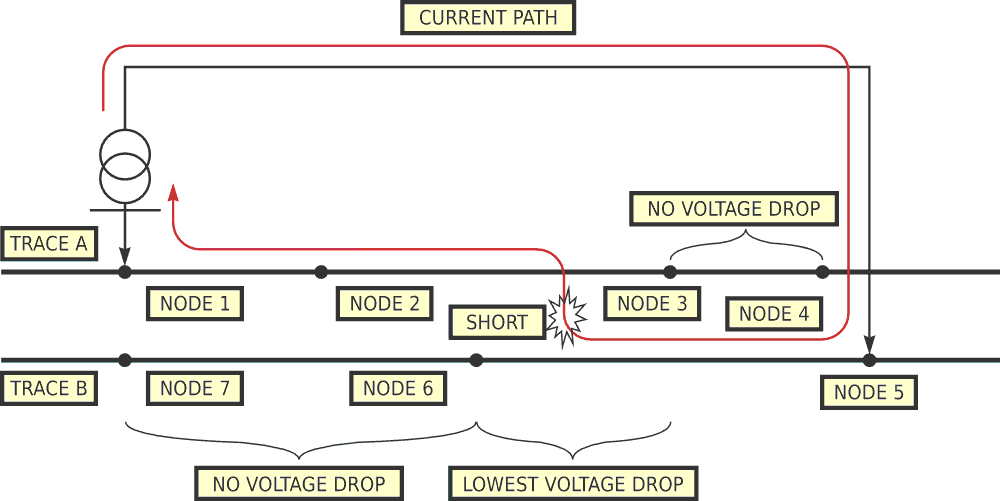

Redrawing Figure 1 with the equivalent circuit in Figure 2 makes clear how this technique works. You are now looking at a simple series network of resistors and looking for voltage drops across any resistor that has current flowing through it. When a node is outside the current path, no voltage drop occurs. By understanding the relationship of each of the vias and their position in the current path, you can systematically isolate the short by looking for lower voltage (current flowing) or higher voltage (current not flowing). When current is flowing, the short is farther from the current source. If no current is flowing, then the short is closer to the current source. This two-valued logic makes it simple to isolate the problem. The beauty of this technique is that it doesn't matter to which two nodes the current source is connected, as long as one side of the current source is connected to any node on Trace A and the other side of the current source is connected to any node on Trace B.
The equivalent circuit of the pc-board layout shows the principal of the source-and-probe technique.
Figure 2. The equivalent circuit of the pc-board layout shows the principal of the source-and-probe technique.
In this example, the short is between two node pairs, and you can isolate the short only to those pairs. A little knowledge of the board layout and common sense now come into play. You need to know only where the two traces are adjacent between nodes 5 and 6 and nodes 2 and 3, and you have found the most likely place for the short. If it is underneath a component, you have to remove the component; removing the component often removes the short. If the short is on an internal layer, you may have to do some selective cutting and jumping to isolate the short from the traces, but at least you minimize the number of cuts on the board.
