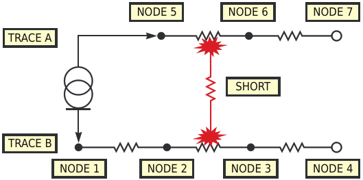

The equivalent circuit of the pc-board layout shows the principal of the source-and-probe technique
Teno P. Cipri
Quickly find pc-board shorts with low-cost tracer technique
Figure 2
9 Kb
Figure 1. By applying a fixed current to various nodes and looking at the resultant voltage drops, you can home in on the likely location of a pc-board short circuit
Figure 2. The equivalent circuit of the pc-board layout shows the principal of the source-and-probe technique
