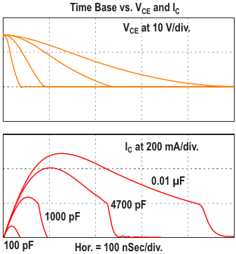

Figure 1. A badly designed switching circuit requiring the 2N2222 at Q1 to repeatedly dump the charge of capacitor C1 of 0.01 µF
Figure 2. The voltage versus current Lissajous pattern for Q1
Figure 3. Safe operating area reconstruction of the 2N3053 and 2N3053A SOA chart taken from a very old datasheet from RCA
Figure 4. SOA examination using logarithmic scaling
Figure 5. The effects of reducing the capacitance of C1
Figure 6. The effects of including a collector resistance
