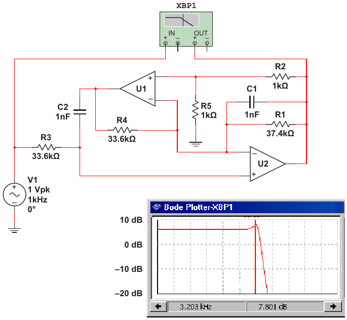

This SPICE simulation of the low-pass filter circuit seemingly shows peaking
John Dunn
Dual amplifier active filters
Figure 2
24 Kb
Figure 2. This SPICE simulation of the low-pass filter circuit seemingly shows peaking
Figure 3. This SPICE simulation of the high-pass filter circuit also seemingly shows peaking
Figure 4. This SPICE simulation of the modified low-pass filter circuit is absent any peaking
Figure 5. This SPICE simulation of the modified high-pass filter circuit is also absent any peaking
