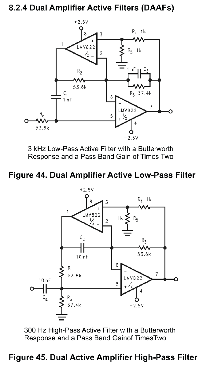

I came across an online datasheet for some op-amps where I found two schematics that intrigued me. Screen-shotting them together resulted in the following montage (Figure 1).
Two published filter circuits that caught the author's eye.
Figure 1. Two published filter circuits that caught the author’s eye.

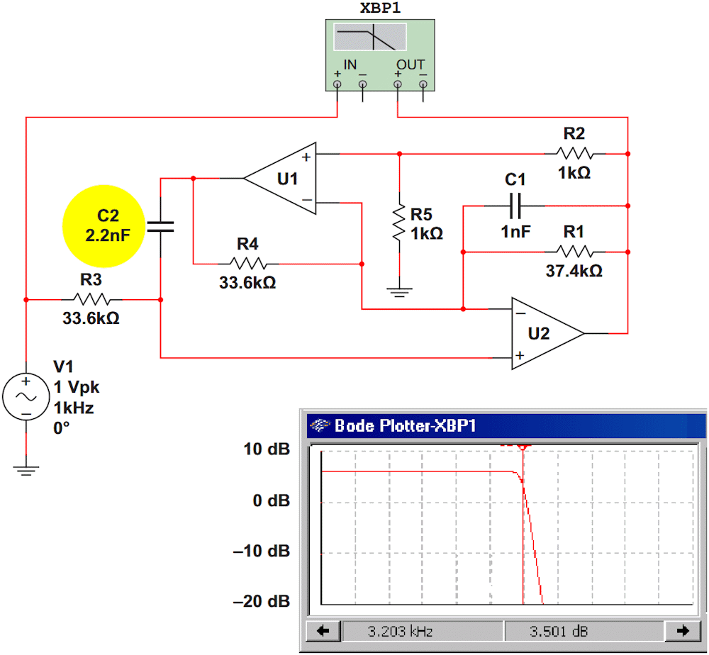

This SPICE simulation of the low-pass filter circuit seemingly shows peaking.
Figure 2. This SPICE simulation of the low-pass filter circuit seemingly shows peaking.

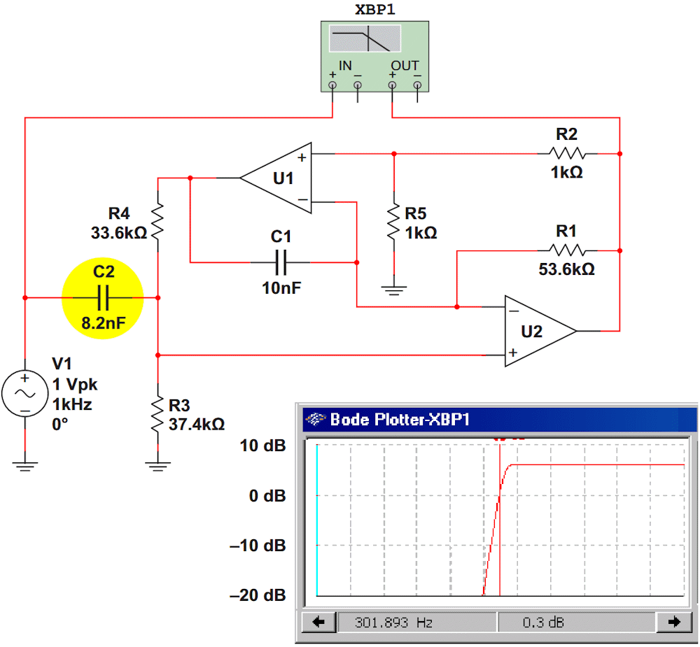

This SPICE simulation of the high-pass filter circuit also seemingly shows peaking.
Figure 3. This SPICE simulation of the high-pass filter circuit also seemingly shows peaking.

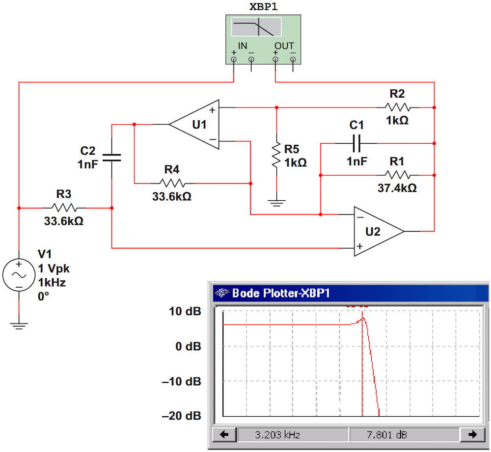

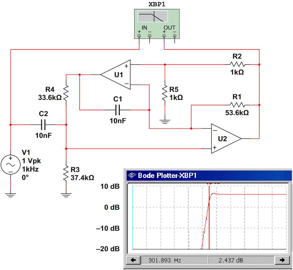

Both simulations show peaking in their frequency responses, which for a Butterworth filter is not supposed to be the case. I then modified the circuits as shown in Figures 4 and 5, with the simulation results again also included in the graphics.
This SPICE simulation of the modified low-pass filter circuit is absent any peaking.
Figure 4. This SPICE simulation of the modified low-pass filter circuit is absent any peaking.
This SPICE simulation of the modified high-pass filter circuit is also absent any peaking.
Figure 5. This SPICE simulation of the modified high-pass filter circuit is also absent any peaking.
One change to each filter, highlighted in the graphics, seemed to correct the peaking issue. Whether the modified filter coefficients are truly Butterworth might be questioned, but for all practical purposes, these two changes seem good enough.
The applicable caveat is that if you really do need a Butterworth or Chebyschev or Bessel or Elliptical or… filter frequency response, don’t just blindly follow whatever example you might find printed, no matter who wrote it. Check your design independently of any supplier’s application note(s).
