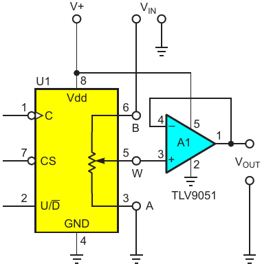

Dpot U1 runs in straightforward voltage-division potentiometer mode with unity-gain buffer A1 providing isolation from output loading. So everything should be nicely ideal with VOUT = VIN(RWA/RBA)

Dpot U1 runs in straightforward voltage-division potentiometer mode with unity-gain buffer A1 providing isolation from output loading So everything should be nicely ideal with V sub OUT /sub  = V sub IN /sub (R sub WA /sub /R sub BA /sub )
