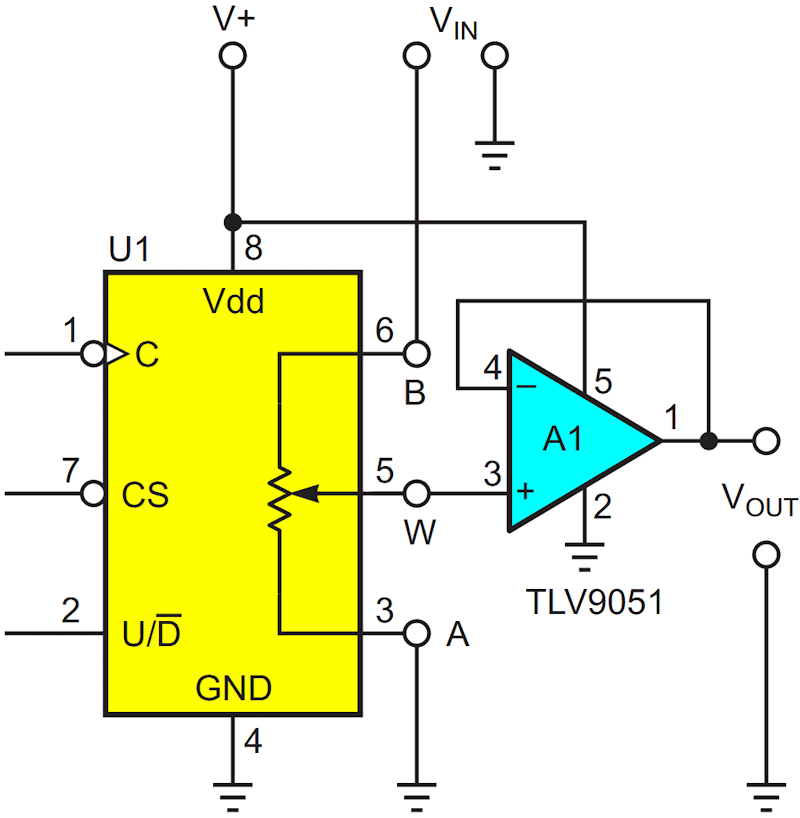

Figure 1 shows a simple Dpot output buffer that should work fine when the error terms are small.
Dpot U1 runs in straightforward voltage-division potentiometer mode with unity-gain buffer A1 providing isolation from output loading. So everything should be nicely ideal with VOUT = VIN(RWA/RBA).
Figure 1. Dpot U1 runs in straightforward voltage-division potentiometer mode with

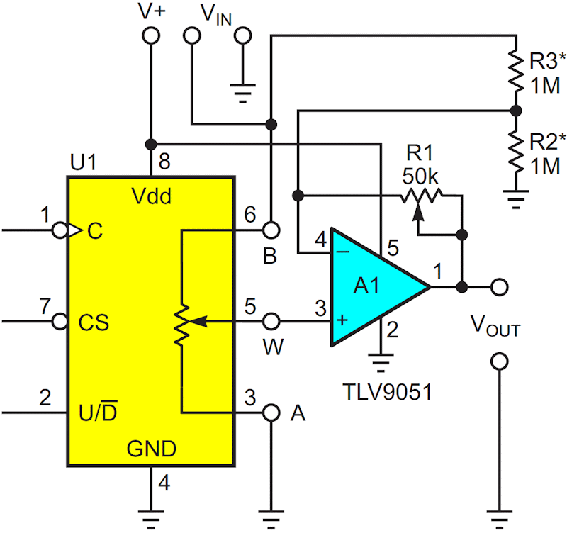

In any precision-critical application, those 3% offsets are likely to be unacceptable. Fortunately, Figure 2 suggests how a simple 3-resistor error-nulling fix is possible.
If R1 = R2 × (scale error) then the errors disappear and VOUT = VIN(RWA/RBA).
Figure 2. If R1 = R2 × (scale error) then the errors disappear
Here’s how it works. Note that, for best performance, R2 and R3 should equal each other to ~0.1% and R1 should be adjusted equal to R1 = ScaleErrorPercentage × R2. An easy way to accomplish this is as follows:
  1. Adjust U1 to its maximum UP setting. Then RWA = RBA.
  2. Set VIN = V+ – 100 mV or so. The exact voltage isn’t critical; we’re just insuring that A1 won’t saturate.
  3. Connect a sensitive voltmeter between VIN and VOUT.
  4. Adjust R1 to null the meter reading and force VOUT = VIN.
Done.
In some applications, error cancellation might be good enough with R1 equal to a fixed value calculated from the datasheet figures, instead of needing post-assembly calibration. 31 kΩ, for example, would align with the MAX5451’s data.
