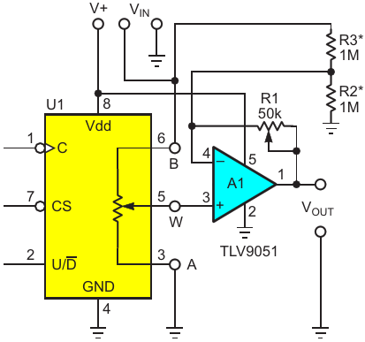

Nifty nulling of non-negligible dpot "scale" errors
Figure 2
14 Kb
Figure 1. Dpot U1 runs in straightforward voltage-division potentiometer mode with unity-gain buffer A1 providing isolation from output loading. So everything should be nicely ideal with V
OUT
= V
IN
(R
WA
/R
BA
Figure 2. If R1 = R2 × (scale error) then the errors disappear and V
OUT
= V
IN
(R
WA
/R
BA
