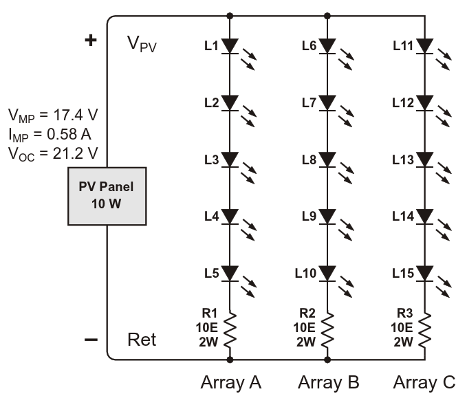

This schematic of the 10 W solar day lamp includes resistive current limiting

Solar day lamp designs use passive and active current-limiting circuits
Figure 1. This schematic of the 10 W solar day lamp includes resistive current limiting
