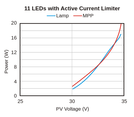

Figure 10. Compare the power output of a lamp with 11 LED arrays to the MPP curve

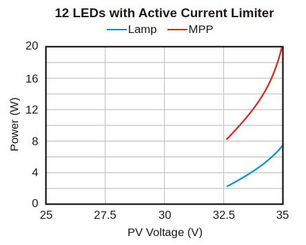

Figure 11. Compare the power output of a lamp with 12 LED arrays to the MPP curve

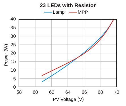

Figure 12. Compare the power output of a lamp with 23 LED arrays to the MPP curve
