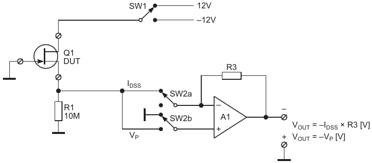

A simple circuit to let you characterize JFETs more accurately
Figure 2
12 Kb
Figure 1. A standard N-JFET drain-source current vs gate-source voltage curve
Figure 2. A basic, improved circuit for the JFET I
DSS
and V
P
measurement
