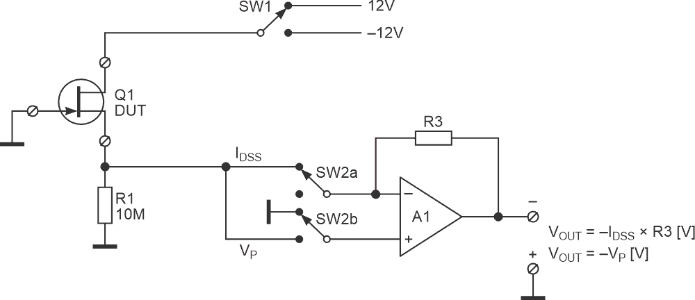

The accuracy of the circuit can be drastically increased by making a couple of minor changes. Figure 2 shows the basic circuit.
A basic, improved circuit for the JFET IDSS and VP measurement.
Figure 2. A basic, improved circuit for the JFET IDSS and VP measurement.
An astute reader will immediately see the two circuits’ similarities and differences. Switch 1 is, again, used to select between N-channel JFETs and their less common sibling: P-channel JFETs.
Switch 2 is used to select between VP and IDSS measurement. In the position as drawn, IDSS is measured. In this position, A1 is set up as a transimpedance amplifier.
With the op-amp’s non-inverting input connected to ground, A1 will keep the inverting input, and hence the source, to ground as well. This guarantees that the true IDSS is measured. Resistor R3 then converts the current to a voltage that can be measured at the output of A1.
When Switch 2 is flipped to the other position, A1 is set up as a simple voltage follower. The pinch-off voltage that develops across R1 is then buffered and available at the output of A1.

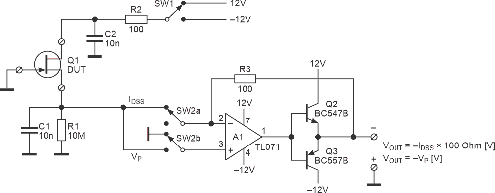

Now that we have seen the basic circuit, we can look at a full implementation (Figure 3). Resistor R2 limits the current that can flow in case a JFET is inserted incorrectly. In pinch-off measurement mode, the impedances around Q1, R1 and A1 are all pretty high. To limit the influence of noise, capacitor C1 is added. It is best to keep these wires short and/or to build the circuit in a shielded box.
First implementation of the practical circuit used to measure IDSS and VP.
Figure 3. First implementation of the practical circuit used to measure IDSS and VP.
Most operational amplifiers can only source or sink a small amount of current. The drain-source saturation current can easily be in the tens of milliamperes. To boost the current output capabilities of A1, a complementary bipolar transistor output stage is added. Please note that the output is not short-circuit proof. If preferred, a simple 1 kΩ to 10 kΩ resistor can be added in series with the output.
With the current resistor values in the circuit, a pinch-off voltage of ±10 V can be measured and a saturation current of ~ ±100 mA.

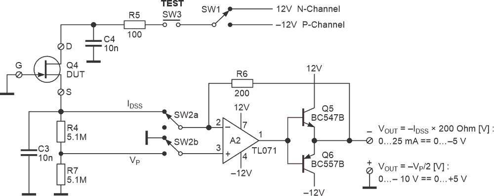

Although there are JFETs with large saturation currents (think J109 with IDSS > 40 mA and J108 with IDSS > 80 mA!), this is simply not needed for most JFETs. So, a variation on this circuit was developed. The pinch-off voltage remained the same, but the saturation current was returned to 25 mA, covering almost all JFET types. A further requirement was that the output voltage range for both measurements needed to be the same: 0 … ±5 V. This was so that a moving coil meter readout could be used with a single range.
See Figure 4 for the implementation.
A circuit with the tailored measurement range that is suited for most JFETs.
Figure 4. A circuit with the tailored measurement range that is suited for most JFETs.

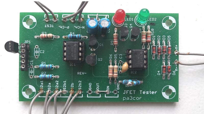

Over the years, manufacturers have created JFETs with almost every possible pin-out, so making a single universal test socket is not so trivial. With three leads, there are 3! = 6 possible combinations as shown in Table 1.
Table 1. The six possible pin-out combinations that
can be used for an off-the-shelf JFET
# Pin-out
1 G D S
2 G S D
3 D G S
4 D S G
5 S G D
6 S D G
Of course, a JFET with a pin-out of S-D-G (#6) can be tested in a socket with pin-out G-D-S (#1), simply by inserting it reverse in the socket. This effectively eliminates half of the possible combinations. So we are left with the following three, as shown in Table 2.
Table 2. A reduction in the number of pin-out combinations by
simply reversing the component within the test socket
# Pin-out
1 G D S
2 G S D
3 D G S
4 = #2 reverse
5 = #3 reverse
6 = #1 reverse
After a bit of doodling, we can create a single five-pin test socket that can accommodate every possible JFET pin-out as shown in Table 3 and in Figure 6.
Table 3. A singular 5-pin test socket to accommodate
all possible JFET pin-outs
# Pin-out
  D S G D S
The final PCB implementation of the practical JFET circuit used to measure IDSS and VP, showing the test socket.
Figure 6. The final PCB implementation of the practical JFET circuit used to measure IDSS
There are two different variants possible; this is left as an exercise to the reader. The same logic can be applied to create universal test sockets for bipolar transistors, of course.
