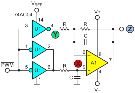

Inherently DC accurate 16-bit PWM TBH DAC
Figure 1
13 Kb
Figure 1. The INL is canceled by the TBH topology
Figure 2. TBH principle sums two 8-bit PWM signals in one 16-bit DAC = V
REF
(MSBY+LSBY/256)/256. The asterisked resistors are 0.25% precision types. It is assumed that the PWM frequency (F
PWM
) is ~10 kHz
Figure 3. Settling time to full precision requires ~100 PWM cycles = 10 ms for F
PWM
= 10 kHz
