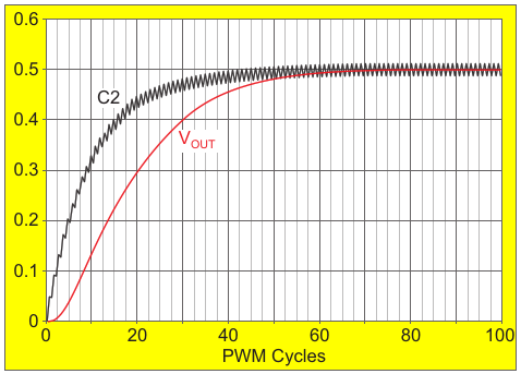

Settling time to full …
Settling time to full precision requires ~100 PWM cycles = 10 ms for F

Figure 3. Settling time to full precision requires ~100 PWM cycles = 10 ms for F
PWM
= 10 kHz
