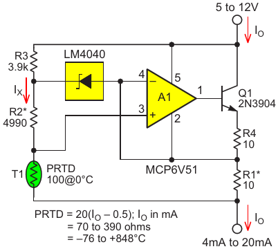

The PRTD 4 to 20 mA loop transmitter with constant current PRTD excitation that relies on 2nd order software nonlinearity correction math

Positive analog feedback linearizes 4 to 20 mA PRTD transmitter
Figure 1. The PRTD 4 to 20 mA loop transmitter with constant current PRTD excitation that relies on 2nd order software nonlinearity correction math
