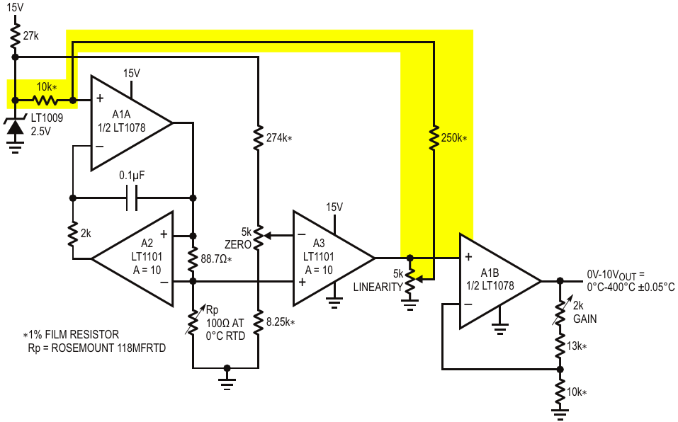

A platinum RTD bridge …
A platinum RTD bridge where feedback to the bridge from A3 linearizes the circuit

Figure 2. A platinum RTD bridge where feedback to the bridge from A3 linearizes the circuit
