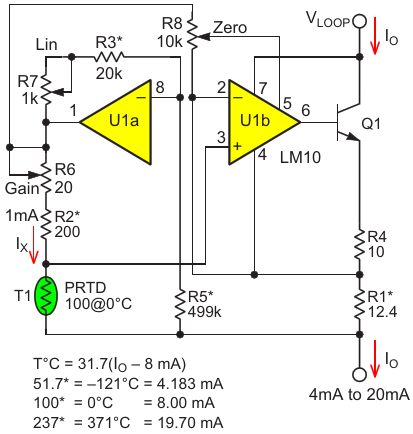

Linearized temperature transmitter modified for a post-assembly tweaking using his procedure

Figure 5. Linearized temperature transmitter modified for a post-assembly tweaking using his procedure
