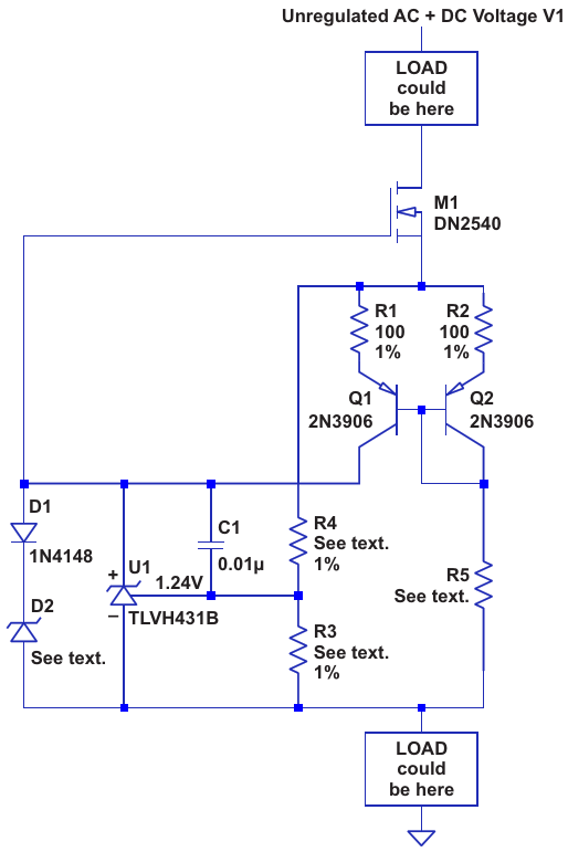

This circuit delivers predictable currents to U1 and M1 and therefore to a load. It's a true two-terminal current source which accommodates load connection to both low and high side

This circuit delivers predictable currents to U sub 1 /sub  and M sub 1 /sub  and therefore to a load It's a true two-terminal current source which accommodates load connection to both low and high side
