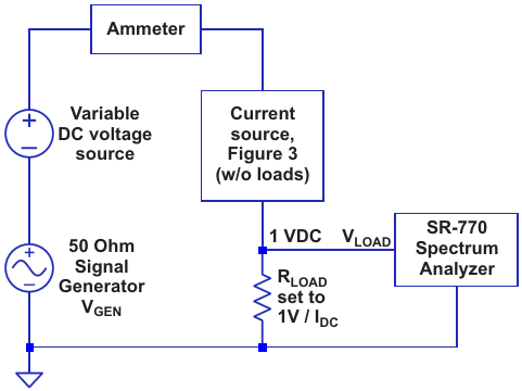

Figure 4. Circuit used to test the impedance of the Figure 3 current source
